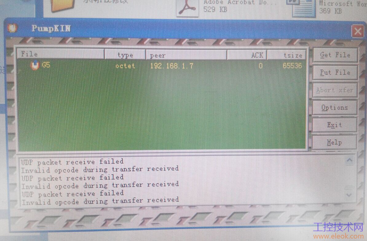

、打开GE的PumpKIN.exe,安装Modbus_TCP Server_v2.0.rom,失败,显示“UDP packet receive failed Invalid opcode during transfer received”。
