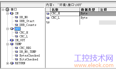

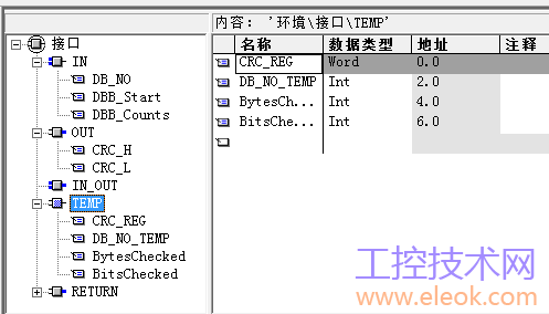

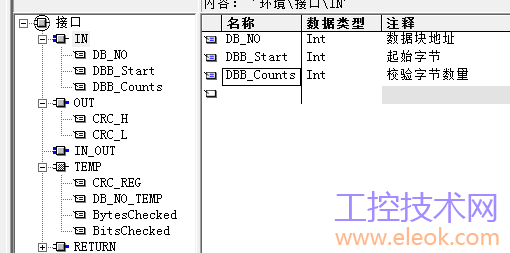

S7 自编modbus_rtu CRC
genie0088 发表于 2016-4-6 09:20:29 | 显示全部楼层 |阅读模式
L     W#16#FFFF
      T     #CRC_REG                    //预置CRC寄存器
      L     #DB_NO
      T     #DB_NO_TEMP                 //数据块地址器
      OPN   DB [#DB_NO_TEMP]
      L     #DBB_Start                  //读入校验起始字节
      SLD   3
      LAR1
      L     #DBB_Counts                 //读入校验字节数量
_A:   T     #BytesChecked               //字节处理循环
      L     DBB [AR1,P#0.0]
      L     LB     1
      XOW
      T     LB     1
      L     8
_B:   T     #BitsChecked                //位处理循环
      L     #CRC_REG
      SRW   1
      T     #CRC_REG
      JZ    _C                          //检验移出位是否为1
      L     #CRC_REG
      L     W#16#A001
      XOW
      T     #CRC_REG
_C:   L     #BitsChecked                //校验下个位
      LOOP  _B
      +AR1  P#1.0                       //校验下个字节
      L     #BytesChecked
      LOOP  _A
      L     LB     1                    //输出校验码
      T     #CRC_H
      L     LB     0
      T     #CRC_L
