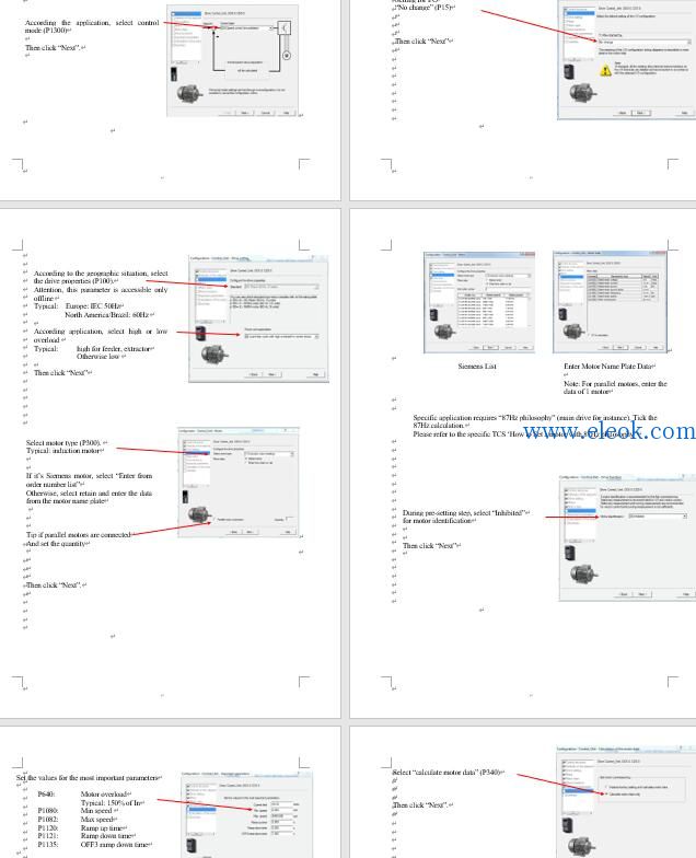

Usually . we used G120C in automatic control recentlly. i introuduce how to set G120C here for someone who need this.
目录:
1.        Wiring        4
2.        On Line Access        5
2.1. Step 1: Profibus Address        5
2.2. Step 2: First connection with STARTER        5
2.3. Step 3: Go Online with a VFD with STARTER        6
3.        Setting        7
3.1. Step 1: Pre-Setting for motor rotation test        7
3.2. Step 2: Motor Rotation Test        15
3.3. Step 3: Full setting        16
3.3.1. Motor identification        16
3.3.2. Ramp Function Generator        17
3.3.3. Brake Control Function        17
3.3.4. Flying Restart Function        18
3.3.5. Vdc Controller Function        18
3.3.6. Automatic Restart Function        19
3.3.7. Motor Temperature Function        19
3.3.8. Communication        20
3.3.9. References        21
3.4. Step 4: Optimization when process is running        22
3.5.Step 5: Save Project        22
