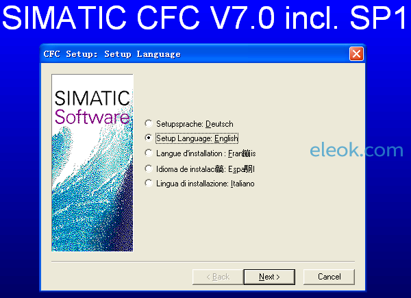

4        Installation
4.1        Installing CFC
When you install CFC V7.0 SP1, you can overwrite an existing installation of CFC.
CFC can only be installed after STEP 7 has been completely installed.
The Setup program automatically installs CFC on the drive containing the STEP 7 software.
Insert the CFC CD in the drive. To install CFC, double-click the SETUP program on the CFC CD from the Windows Explorer. The Setup program will guide you through the installation.
