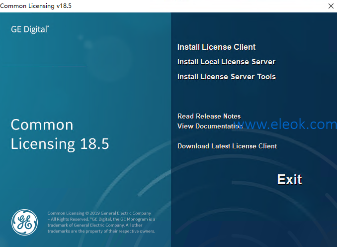

Build:                Common Licensing 18.5.1581.0
Date:                Feb 2019
Installation
        1. Install Common Licensing on your client machine.
        2. If your setup requires a License Server then -
                - click on the 'Install License Server' button to install the License Server.
                - click on the 'Install License Server Tools' button to install the License Server Administration Tool.
