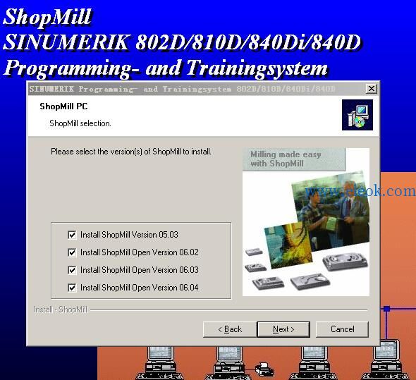

                        ShopMill                 Version 05.03
                        ShopMill                 Version 06.02 Open
                        ShopMill                 Version 06.03 Open
                        ShopMill                 Version 06.04 Open

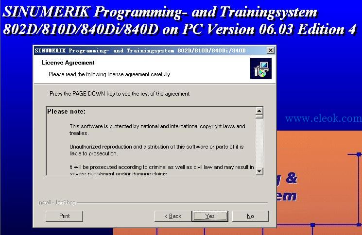

        Installation:
1.        Before installing SinuTrain, make sure that no HMI version is installed on the computer! Once SinuTrain is installed, do not install any other HMI version.
2.        Before installing SinuTrain, make sure that no STEP5 version is installed on the computer (reason: once SinuTrain is installed, the MPI links of STEP5 will be lost.).
3.        To install SinuTrain, you will need a valid function key. The function key is included when you purchase the SinuTrain CD.
4.        To run SinuTrain, you will need a valid License Key. The License Key is available on an USB flash drive that is included in the SinuTrain scope of supply. The License Key must be transferred to the PC prior to the initial start-up of SinuTrain. For this purpose, an additional program - the Automation License Manager - is installed during the installation of SinuTrain. The Automation License Manager permits transfer of the License Key to the PC (please observe the information in section 12).
Note: The license key for Edition 3 is also valid for Edition 4.
5.        During the installation process, you are prompted to insert the CD2 (documentation). This installation step must be performed. Should you abort this step, SinuTrain can neither be started nor deinstalled later.
6.        More detailed information regarding the installation (among others, “settings before the first start“ of SinuTrain) is provided in the “Getting Started“ included (SinuTrain_Master.pdf).

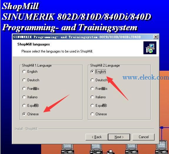

2.        Language selection
Installed languages include English, French, German, Italian, Spanish and Chinese. During the setup, you will be required to select two of the installed languages. These can be switched online (Start-up menu).
For information about additional available languages, please go to:
http://www.siemens.de/sinumerik/training
