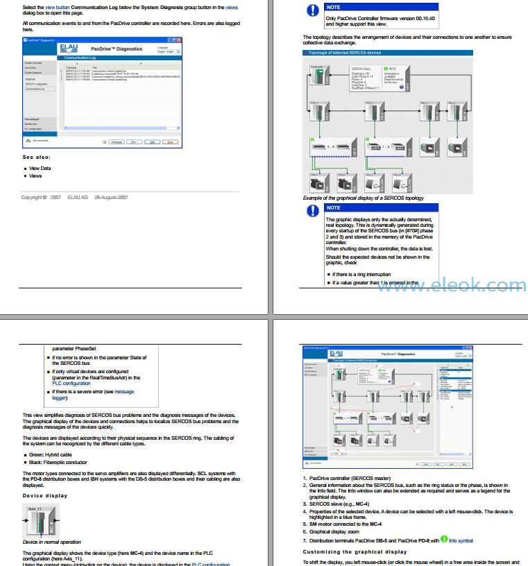

Hardware and Software Versions
Message Logger
Controller Configuration
Communication Log
SERCOS Topology
Info Symbol
Diagnosis Message
SERCOS Error
Permanent SERCOS ring interruption
