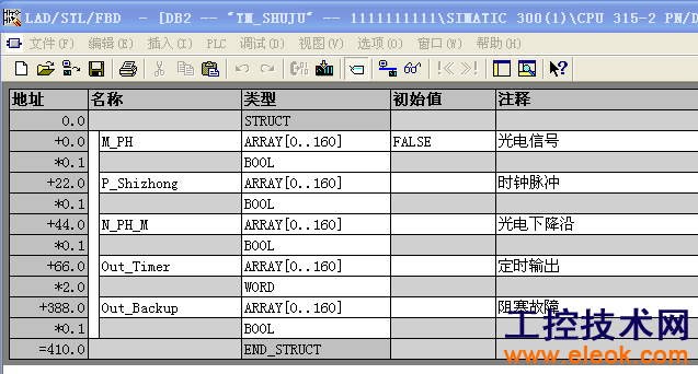

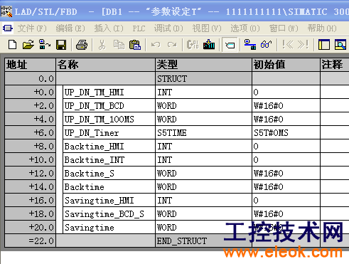

各位大侠:
       本人新手,望指点,我有两段语句表程序,不知有哪位大侠能为我做下注解:
程序段①:
      L     0                                  //装载0
      T     #INDEX1                     //把0传送到#INDEX1
N0:   L     #INDEX1
      ITD
      LAR1
      SLD   4
      LAR2
      A     M [AR1,P#200.0]
      OPN   "TM_SHUJU"
      A     DBX [AR1,P#0.0]
      JCN   N1
      A     "P_0.5s"
      OPN   "TM_SHUJU"
      FP    DBX [AR1,P#22.0]
      A(
      L     DBW [AR2,P#66.0]
      OPN   "参数设定T"
      L     DBW   10
      <I
      JNB   N1
      L     1
      OPN   "TM_SHUJU"
      L     DBW [AR2,P#66.0]
      +I
      T     DBW [AR2,P#66.0]
N1:   OPN   "TM_SHUJU"
      A     DBX [AR1,P#0.0]
      FN    DBX [AR1,P#44.0]
      JNB   N2
      L     0
      T     DBW [AR2,P#66.0]
N2:   OPN   "TM_SHUJU"
      L     DBW [AR2,P#66.0]
      OPN   "参数设定T"
      L     DBW   10
      ==I
      OPN   "TM_SHUJU"
      =     DBX [AR1,P#388.0]
      L     #INDEX1
      INC   1
      T     #INDEX1
      L     160
      <I
      JC    N0

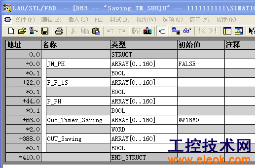

程序段②:
      L     0                                  //装载0
N30:  L     #INDEX1
      ITD
      LAR1
      SLD   4
      LAR2
      A     M [AR1,P#200.0]
      OPN   "Saving_TM_SHUJU"
      AN    DBX [AR1,P#0.0]
      JCN   N31
      A     "P_1s"
      FP    DBX [AR1,P#22.0]
      A(
      L     DBW [AR2,P#66.0]
      OPN   "参数设定T"
      L     DBW   16
      <I
      JNB   N31
      L     1
      L     DBW [AR2,P#66.0]
      +I
      T     DBW [AR2,P#66.0]
N31:  OPN   "Saving_TM_SHUJU"
      A     DBX [AR1,P#0.0]
      FP    DBX [AR1,P#44.0]
      O(
      AN    "M111.1"
      JNB   N32
      L     0
      T     DBW [AR2,P#66.0]
N32:  OPN   "Saving_TM_SHUJU"
      L     DBW [AR2,P#66.0]
      OPN   "参数设定T"
      L     DBW   16
      ==I
      =     DBX [AR1,P#388.0]
      L     #INDEX1
      INC   1
      T     #INDEX1
      L     160
      <I
      JC    N30
如果能转换成梯形图的话我再加一百分
P_0.5s:   注释为0.5秒脉冲
P_1s:      注释为为1秒脉冲
M111.1: 注释为系统自动运行
另外还附上三张图片现如下:
