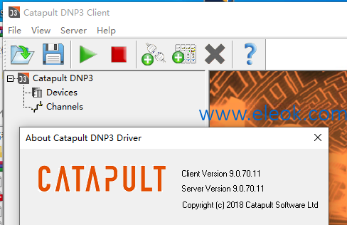

Now that you have the basic information needed, you can set-up a basic communication link. Start by defining a device in the DNP3 driver.
1) From the Catapult DNP3 Client window, expand the explorer tree on the left side (with a root of "Catapult DNP3"). The tree will expand into two branches: Devices and Channels.
2) Now click on the "Add Device" button from the toolbar (or right-click on the "Devices" branch and select "Add Device" from the pop-up menu).
3) On the dialog box that appears, enter the name of the DNP3 device on the first field. This can be an RTU name like SEL351, or a location like "Downtown". For the purposes of this guide, use a device name of "TEST".
4) Click "OK" to exit the dialog box.
This will create a new device called "TEST", ready for communications.
