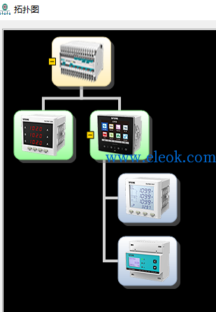

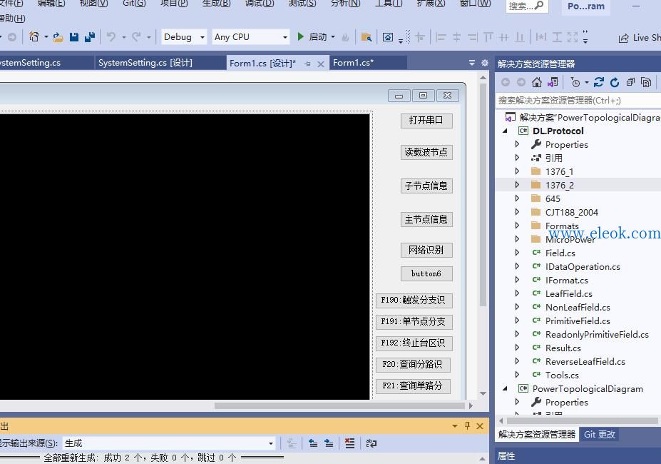

C#语言用GoDiagram for WinForms控件动态实现电网拓扑图绘制,要通过串联接CCO下发376.2协议效果如下:
第一步 、初始节点构造:
68 68 00 83 00 00 28 00 00 1A 21 08 02 02 00 04 01 00 44 02 00 03 21 00 04 0D 01 12 13 14 15 16 17 00 00 00 00 01 01 45 02 00 03 20 00 04 0D 01 12 13 14 15 16 17 00 00 00 00 01 01 46 02 00 03 21 00 04 0D 01 45 02 00 03 20 00 00 00 00 00 01 01 46 03 00 03 21 00 04 0D 01 45 02 00 03 20 00 00 00 00 00 01 01 BE 16
构造结果如下图

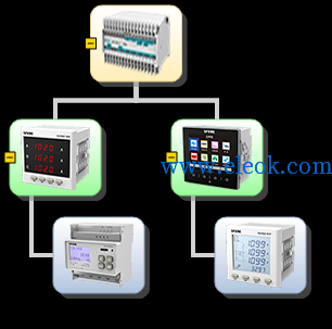

第二步、a 修改节点 46 03 00 03 21 00 他的父节点为左边的叶子节点
68 29 00 83 00 00 28 00 00 1A 21 08 02 02 00 01 01 00 46 03 00 03 21 00 04 0D 01 44 02 00 03 21 00 00 00 00 00 01 01 DF 16
