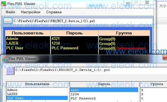

Passwords on many OP Siemens where the development program WinCC Flexible is stored in the PData.pwl file usually this file can be copied from the panel or USB Flash drive,either over the network.
注意需要你有pwl文件才可以分析密码(不支持博图版本,仅支持传统的WinCC Flexible),没有pwl文件请不要下载,仅用于自己学习用途,严禁用于分析别人的设备,否则不要下载此程序。
FlexPwlpassword.rar (129.86 KB, 售价: 10 E币)
