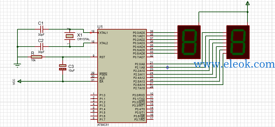

仿真电路图:
汇编程序代码:
  1. SECOND EQU 30H
  2. TCOUNT EQU 31H
  3. ORG 0000H
  4. START:CLR P1.7;
  5.       MOV SECOND,#60;
  6.       MOV TCOUNT,#00H;
  7.       MOV TMOD,#01H;
  8.       MOV TH0,#3CH;
  9.       MOV TL0,#0B0H;
  10.       SETB TR0;
  11.
  12. DISP: MOV A,SECOND;
  13.       MOV B,#10;
  14.       DIV AB;
  15.       MOV DPTR,#TABLE;
  16.       MOVC A,@A+DPTR;
  17.       MOV P0,A;
  18.       MOV A,B;
  19.       MOVC A,@A+DPTR;
  20.       MOV P2,A;
  21. WAIT: JNB TF0,WAIT;检查是否50ms计时到
  22.       CLR TF0;
  23.       MOV TH0,#3CH;
  24.       MOV TL0,#0B0H;
  25.       INC TCOUNT;
  26.       MOV A,TCOUNT;
  27.       CJNE A,#20,NEXT;判断计时的50ms次数是否20次,即判断是否计时了一秒钟
  28.       MOV TCOUNT,#00H;
  29.       DEC SECOND;
  30.       MOV A,SECOND;
  31.       CJNE A,#00,NEX; 判断是否计时了一分钟,如果够了则重新开始
  32.       MOV SECOND,#60;
  33. NEXT: LJMP WAIT;
  34. NEX:  LJMP DISP;
  35. TABLE:
  36. DB 0C0H,0F9H,0A4H,0B0H,99H,92H,82H,0F8H,80H,90H
  37. END
