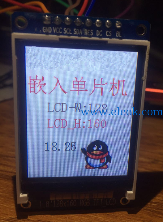

在网上看到stm32驱动1.8寸tft-lcd(st7735)的程序挺少的,所以本人弄了一个程序,程序绝对可行(本人弄的)芯片:stm32f10x系列

  12.         LCD_Init();//LCD初始化
  13.         LCD_Fill(0,0,LCD_W,LCD_H,WHITE);
  14.         LED=0;
  15.         while(1)
  16.         {
  17.                 LCD_ShowChinese(0,0,"湛江市电子",BLUE,WHITE,24,0);
  18.                 LCD_ShowChinese(0,30,"嵌入单片机",RED,WHITE,24,0);
  19.
  20.                 LCD_ShowString(24,60,"LCD-W:", BROWN ,WHITE,16,0);
  21.                 LCD_ShowIntNum(72,60,LCD_W,3, BROWN ,WHITE,16);
  22.                 LCD_ShowString(24,80,"LCD_H:",RED,WHITE,16,0);
