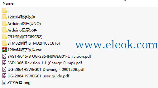

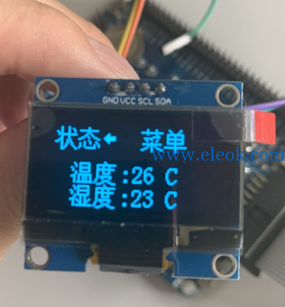

根据基本例程修改实现  基本的 选定、翻页、显示字库, 内含取模软件及教程。
IIC-OLED显示屏资料(SSD1306).7z (4.19 MB, 售价: 3 E币)

部分源码:
  1. #include "stm32f10x.h"
  2. #include "OLED_I2C.h"
  3. #include "delay.h"
  4. #include "key.h"
  5. u8 key=0;
  6. u8 test=0;
  7. int main(void)
  8. {
  9.         unsigned char i=0;
  10.         unsigned char JI;
  11.         unsigned char ASD=2;
  12.         extern const unsigned char BMP1[];
  13.         extern  unsigned char F16x16[];
  14.         extern  unsigned char shiduF16x16[];
  15.         extern  unsigned char xuankuangF16x16[];
  16.         extern  unsigned char mochu[];
  17.         DelayInit();
  18.         I2C_Configuration();
  19.         OLED_Init();
  20.         KEY_Init();
  21.         OLED_Fill(0x00);//全屏灭
  22.         test=0;
  23.         while(1)
  24.         {
  25.                 key=KEY_Scan(0);
  26.                 if(key)
  27.                         {
  28.
  29.                                 switch(key)
  30.                                 {
  31.
  32.                                 case 1:
  33.                                         OLED_CLS();//清屏
  34.
  35.                                  //DelayS(1);
  36.                                 if(test==0){
  37.                                         for(JI=0,i=2;i<4;i++)
  38.                                         {
  39.                                                 OLED_ShowCN(70+JI*16,1,i,F16x16);//菜单
  40.                                                 JI++;
  41.                                         }
  42.                                         for(JI=0,i=7;i<9;i++)
  43.                                         {
  44.                                                 OLED_ShowCN(10+JI*16,1,i,F16x16);//状态
  45.                                                 JI++;
  46.                                         }
  47.                                         //`````DelayMs(500);
  48.                                         for(i=0;i<2;i++)
  49.                                         {
  50.                                                 OLED_ShowCN(22+i*16,6,i,shiduF16x16);//湿度
  51.                                         }
  52.
  53.                                         for(i=0;i<2;i++)
  54.                                         {
  55.                                                 OLED_ShowCN(22+i*16,4,i,F16x16);//温度
  56.                                         }
  57.                                         OLED_ShowStr(56,4,":",2);//测试6*8字符
  58.                                         OLED_ShowStr(56,6,":",2);//测试6*8字符
  59.
  60.
  61.                                         DelayS(1);
  62.                                         OLED_ShowStr(64,4,"26 C",2);//测试6*8字符
  63.
  64.                                         DelayS(1);
  65.                                         OLED_ShowStr(64,6,"23 C",2);//测试8*16字符
  66.
  67.                                         OLED_ShowCN(45,1,0,xuankuangF16x16);//箭头
  68.
  69.                                         break;
  70.                                 };
  71.                                 if(test==1)
  72.                                 {
  73.                                 OLED_CLS();//清屏
  74. //                                        //OLED_CLS();//清屏
  75. //                                        //OLED_OFF();//测试OLED休眠
  76. //                                        //DelayS(2);
  77. //                                        //OLED_ON();//测试OLED休眠后唤醒
  78. //                                        OLED_DrawBMP(0,0,128,8,(unsigned char *)BMP1);//测试BMP位图显示
  79. //                                        //DelayS(2);
  80.
  81.
  82.                                         for(i=0;i<ASD*2;i+=2)
  83.                                         {
  84.                                                 for(JI=0;JI<i/2;JI++)
  85.                                                 {
  86.                                                 OLED_ShowStr(10+i*7,7-JI,"@",1);//测试6*8字符
  87.                                                 OLED_ShowStr(10+(i+1)*7,7-JI,"@",1);//测试6*8字符
  88.                                                 }
  89.                                         }
  90.
  91.
  92.                                                 break;
  93. //                                        //OLED_Fill(0xFF);//全屏点亮
  94. //                                        //DelayS(2);
  95.                                 }
  96.                                                                 break;
  97.
  98.
  99.                                 case 2:
  100.                                         ASD++;
  101.                                         if(ASD>=8){ASD=0;}
  102.
  103.
  104.                                         if(test==0)
  105.                                 {
  106.                                                 OLED_ShowCN(45,1,0,mochu);//测试显示中文
  107.                                                 OLED_ShowCN(105,1,0,xuankuangF16x16);//测试显示中文
  108.                                         test++;
  109.                                         break;
  110.                                 }
  111.
  112.                                 if(test==1)
  113.                                 {
  114.
  115.                                                 OLED_ShowCN(105,1,0,mochu);//测试显示中文
  116.
  117.                                                 OLED_ShowCN(45,1,0,xuankuangF16x16);//测试显示中文
  118.                                         test=0;
  119.                                         break;
  120.                                 }
  121.
  122.
  123.
  124.                                 }
  125.                         }
  126.         }
  127. }
