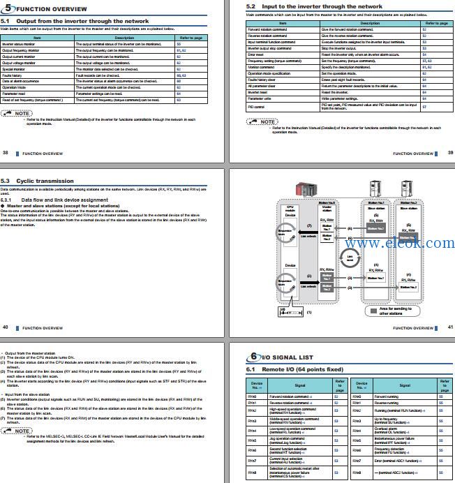

INVERTER Plug-in option FR-A8NCE CC-Link IE Field INSTRUCTION MANUAL
xiaolong 发表于 2022-3-23 11:23:02 | 显示全部楼层 |阅读模式
CC-Link IE Field communication function 网络控制变频器资料
英文版文档:
FR-A8NCE.pdf (5.79 MB, 售价: 10 E币)
1 PRE-OPERATION INSTRUCTIONS 6
1.1 Unpacking and product confirmation............................................................................................................................6
1.2 Parts..................................................................................................................................................................................7
1.3 CC-Link IE Field Network communication specifications ...........................................................................................9
2 INSTALLATION 10
2.1 Pre-installation instructions .........................................................................................................................................10
2.2 Installation procedure ...................................................................................................................................................11
3 WIRING 15
3.1 System configuration example.....................................................................................................................................15
3.2 Network configuration...................................................................................................................................................16
3.3 Network components ....................................................................................................................................................17
3.3.1 Connection cable ................................................................................................................................................................ 17
3.3.2 Hubs.................................................................................................................................................................................... 17
3.4 Wiring..............................................................................................................................................................................18
3.4.1 Ethernet cable connection .................................................................................................................................................. 18
3.4.2 Precautions ......................................................................................................................................................................... 20
4 INVERTER SETTING 23
4.1 Parameter list.................................................................................................................................................................23
4.2 Operation mode setting ................................................................................................................................................25
4.2.1 Operation mode switching and communication startup mode (Pr.79, Pr.340).................................................................... 25
4.3 Operation at communication error occurrence ..........................................................................................................28
4.3.1 Operation selection at communication error occurrence (Pr.500 to Pr.502, Pr.779) .......................................................... 28
4.3.2 Fault and measures ............................................................................................................................................................ 32
4.4 Inverter reset..................................................................................................................................................................33
4.5 CC-Link IE Field Network function setting..................................................................................................................354
4.5.1 Network number setting (Pr. 434) ....................................................................................................................................... 35
4.5.2 Station number setting (Pr. 435) ......................................................................................................................................... 35
4.5.3 Frequency command with sign (Pr. 541) ............................................................................................................................ 36
5 FUNCTION OVERVIEW 38
5.1 Output from the inverter through the network............................................................................................................38
5.2 Input to the inverter through the network ...................................................................................................................39
5.3 Cyclic transmission.......................................................................................................................................................40
5.3.1 Data flow and link device assignment................................................................................................................................. 40
6 I/O SIGNAL LIST 43
6.1 Remote I/O (64 points fixed) .........................................................................................................................................43
6.2 Remote register (128 words fixed)...............................................................................................................................46
7 DETAILS OF I/O SIGNALS 52
7.1 Details of remote input and output signals.................................................................................................................52
7.1.1 Output signals (master module to inverter (FR-A8NCE)).................................................................................................... 52
7.1.2 Input signals (inverter (FR-A8NCE) to master module) ...................................................................................................... 55
7.2 Details of remote register .............................................................................................................................................57
7.2.1 Remote register (master module to inverter (FR-A8NCE))................................................................................................. 57
7.2.2 Remote register (inverter (FR-A8NCE) to master module)................................................................................................. 59
7.2.3 Instruction codes................................................................................................................................................................. 62
7.2.4 Monitor codes ..................................................................................................................................................................... 66
7.3 Torque command by CC-Link IE Field Network communication ..............................................................................67
8 PROGRAMMING EXAMPLES 69
8.1 Programming example for reading the inverter status ..............................................................................................74
8.2 Programming example for setting the operation mode .............................................................................................75
8.3 Programming example for setting the operation commands....................................................................................76
8.4 Programming example for monitoring the output frequency....................................................................................77
8.5 Programming example for parameter reading............................................................................................................785
8.6 Programming example for parameter writing .............................................................................................................79
8.7 Programming example for setting the running frequency ........................................................................................80
8.8 Programming example for fault record reading .........................................................................................................82
8.9 Programming example for resetting the inverter at inverter error............................................................................83
8.10 Instructions ....................................................................................................................................................................84
