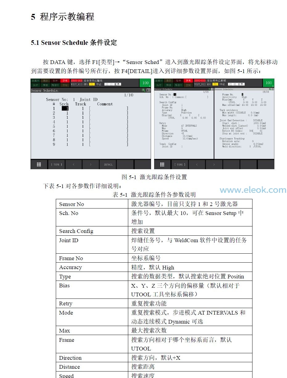

5 程序示教编程 ...................................................16
5.1 Sensor Schedule 条件设定...............................16
5.2 指令说明........................................................17
5.3 程序编程举例.................................................18
